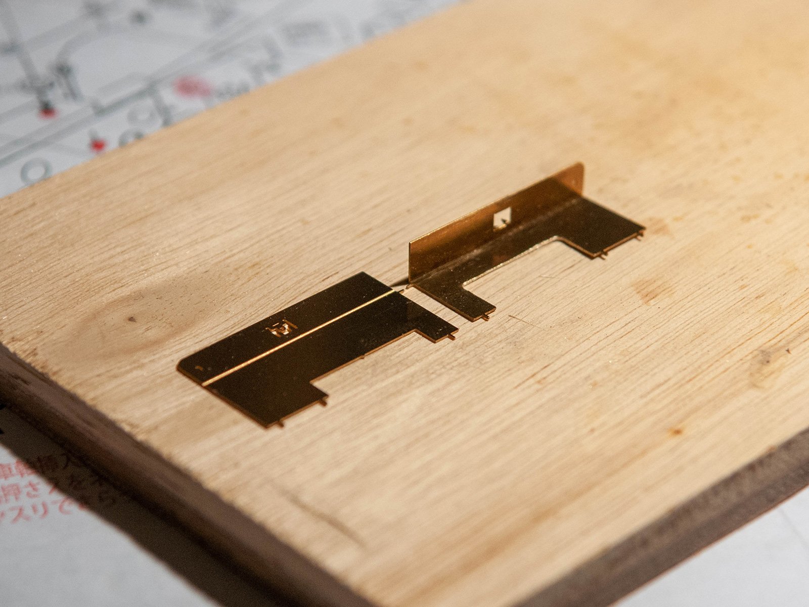

Been working on priming the various parts of the frame. I decided to prime and paint them while completely disassembled rather than building the frame and painting the whole thing in 1 go. This did mean priming it took 2 days though, 1 day for 1 side, then leave it to dry overnight, and then prime the other side. I've used some Blu-tack to hold the parts, but that might not have been the best idea. Blu-tack does contain some sort of oil, and it can leave a residue, however, a lot of modelers use Blu-tack to hold parts while painting, and the stories of residue are mostly talking about using it to tack posters to walls etc. Guess I'll just have to wait and see what happens.
There are a couple of imperfections caused by not so good solder joints, mostly the ones I did before I had some of the additional tools I bought for the SL9600, but those won't be visible after everything is assembled.
For tomorrow, I'm hoping to start the actual painting. All of these parts will be mostly black with a few drops of white most likely, just to make it a little less intense. I'm thinking of doing some small detail bits in a different colour, maybe something like a really dark red or burgundy or something similar. On the one hand, I do want this to be a work horse (hence the intentional damage here and there), but on the other hand, I also want the trains to look good, something the employees of the railway would be proud of, so a little bit of flair like some colour accents and things like mahogany floor and roof would probably be a nice touch. All of that can be added later on though. I will at least spray a little black on some scrap bits of cardboard, and play around with a couple of other colours I have around.

Did a little more research into the colours used by JNR. I was mostly looking for some colours to use for accents, but then I noticed the list of colours used by JNR also contained an entry for 'black' as used on steam locomotives, but also as frame / undercarriage colour of other locomotives, cars and coaches. What surprised me, is that it's actually much less black than I would expect. The overview lists the colours in several notations, and doing a bit of converting, it looks like JNR black is actually 5 parts black and 1 part white, which would make it much lighter than I would expect.
So, been giving the Hokutan #2 frame a bit of colour and clear coat, but I'm not too happy with the results. There are a few issues with it actually. The surface isn't very smooth, which is likely caused by too high pressure on the airbrush (somehow this was set to 40psi, which I likely did to use the airbrush as a compressed air cleaner to get rid of dust, and then forgot to dial it back to around 20 psi). This means needing to keep the airbrush pretty far away from the frame to prevent skating / getting blotches. However, doing so also means the paint dries before hitting the surface. Now, since this is the frame, and much won't be visible, that's really not that much of an issue. However, due to the rough texture, applying clear coat also requires more layers to get it to look flat, which is an issue, because you don't want to add too much clear coat either.
Another issue is that the Blu-tack I used to hold the parts did leave some minor spots. Again, not that much of an issue considering it's the fame, and it will be hidden mostly. I did give double sided tape a try, but this left some marks as well, which were actually more visible than the Blu-tack ones. I'm currently trying some regular old low-tack masking tape, which seems to work well, but larger / heavier parts can fall off, so I need some popsicle sticks or something so I have a little more surface to stick them on.
However, the major issue, is that the paint is just too fragile. I can quite easily scrape it off with my finger nails. For static models I wouldn't be too worried considering you don't handle them, but locomotives tend to be picked up quite a bit, and can of course tip over or drive into things. I'm pretty sure it's not the grey primer I used, considering I used the same primer on some plastic Gundam kits parts, and it sticks much better. I can still scrape it off with my finger nail, but it requires quite a bit of pressure. The Gundam parts can also be sanded without immediately taking off large chunks of primer.
So this means that the problem is likely getting the primer to stick to the metal frame. I might not have scuffed it up enough, or maybe the Mr Metal Primer isn't really doing what it's supposed to be doing.
Anyway, it looks like I may need to strip the frame and start over. It's quite a bit of time wasted, but on the other hand, better this happens on the frame only rather than the whole locomotive. The frame should be relatively easy to clean up at least. Of course, I'll be doing a bit of testing on some scrap metal before starting on the frame again. Might also assemble the frame to see how it looks after painting, at least that way it feels there has been some progress 😄
Also, if anyone with some experience airbrushing metal kits has any tips, I'd gladly take them 😉
Edit: Uploaded a picture of the painted and assembled frame. Shame the paint's not sticking well at all, since it does look pretty good ...
Today in "The saga of the non-sticking paint" ...
After stripping most of the paint from the frame, I started Googling for tips on cleaning and preparing metal for priming. After a couple of hours of not finding anything useful, I came across a video demonstration of a product called 'Metal Prep'. In this video, they used styrene cement to clean a brass detail part for a plastic kit, and then brushed on the Metal Prep on half od the part. Once dry, they painted the whole part, without doing any other priming. Once the paint dried, they started scraping the paint. On the non-prepared half, the paint was coming right off, much like my frame, but on the prepared half, while there were scratches, the paint stuck to the metal.
The video was made by someone of a company called "Vantage Modelling Solutions", so figured I'd check their page, and noticed they seem to have quite a good number of really interesting products. Found an online shop in The Netherlands that sells the products, so decided to order some items for testing, including of course the Metal Prep, styrene cement, liquid mask, and some clear coats / varnishes. I also sent them an email with some questions, and they answered quick, and most of all were very honest. They're not pushing their own product, and even recommend alternatives in the comments of several of their videos, which is pretty decent.
So, today I got a couple of packages with Metal Prep, cement, and some Vallejo paints. So, went and prepared the metal. First I used a fiber glass pen to scuff the surface a bit, not necessary apparently, but it can't hurt either. Then cleaned the surface with styrene cement, which I still think is a strange idea, but surprisingly it worked really well. I was surprised at how much muck was on the q-tip after wiping off the metal. Finally, applied the Metal Prep with a regular old paint brush. You can just about see where you've applied the stuff after it dries. I believe this is mostly the same as the Mr Metal Primer, but the liquid is a bit less transparent.
I let that dry for about half an hour while I was preparing my airbrush, which got clogged up after not cleaning it well after my previous airbrush session. Once done, I used some Vallejo Model Air "sky grey" paint instead of primer. I sprayed it like I normally do (with the PSI set to around 20 instead of 40 ;)) rather than how the video shows it, so multiple thin coats instead of a single heavy coat. I was getting some tip dry, so I'll likely need to order some flow improver and maybe thin the paint a little more. It did go on rather well though, result was pretty smooth for the most part.
I tested some brass, stainless steel and the other sheet metal they use (not sure what this is, might be nickel silver or something similar to that). On the nickel silver I pulled back on the trigger a little further for more paint / faster painting, but that didn't go to well. Only did 2 very light coats, just barely covering the metal, and let it dry for maybe about half an hour again. Once the airbrush was all cleaned up again, I give the paint a quick try. Even after drying for only half an hour, the paint was sticking surprisingly well. I could still scrape it off with a toothpic, but definitely needed more force. Rubbing it with my fingers didn't cause any paint to come off at all, and repeatedly sticking on some masking tape and removing it also didn't cause paint to come off. I'm pretty sure once it's cured overnight, it'll be even tougher, and with some clear coat / varnish, it should be pretty tough.
So, apart from the tip dry, which should be easily fixed, I'm really rather happy with the results so far. I'll check again tomorrow, and maybe try adding a clear coat to see what does does.
