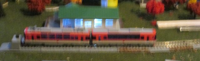

here is a couple of new ones two car emu, an a EH500 with car train

Great you got the picts working! Love eh500s...
