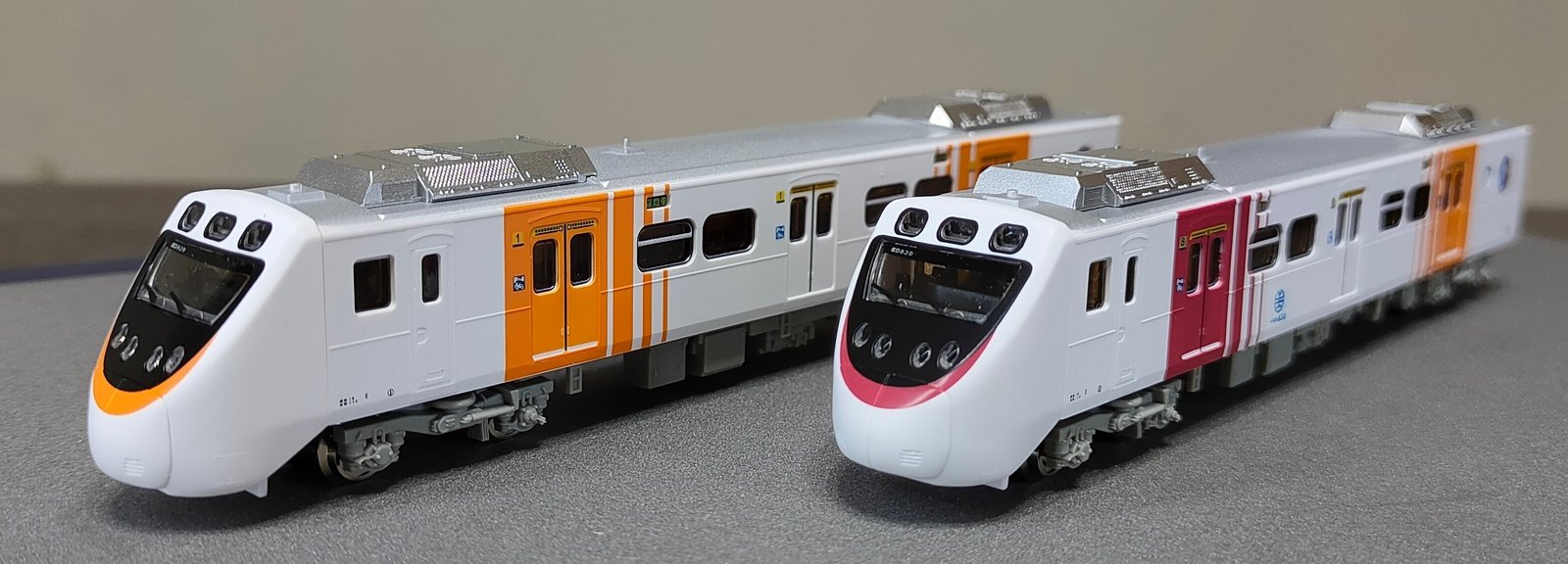

Sanying just released pictures of their TRA EMU800 in JR Shikoku 8000 series livery. The set is scheduled to be released around the end of this month. (As always, all pictures reposted with Sanying's authorization) - Today

That is quite nice detailing and painting on that loco. Pantographs look actually to have a bit more detail to them than most japanese pantographs. They are coming along fast. What is the SRP on one of those? jeff -
