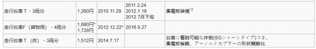

lukewang01 Posted February 21, 2021 Share Posted February 21, 2021 Just found that out: http://kim.s329.xrea.com/btwk/?cmd=read&page=Nゲージ化パーツ&word=シャーシ#motor So product released near 2014 probably can't take KATO bogies directly. Link to comment
