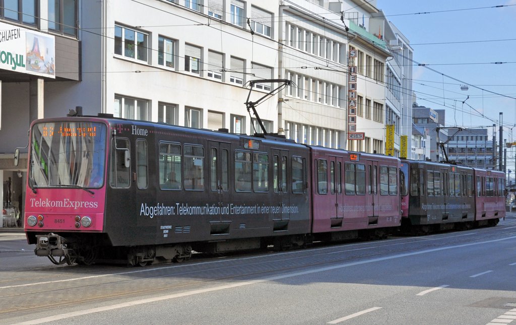

ToniBabelony Posted June 7, 2010 Share Posted June 7, 2010 Its not a train on the road, its a tram line and has a special exemption from the Ministry of Land, Infrastructure, Transport and Tourism. http://www.skyscrapercity.com/showpost.php?p=34034786&postcount=7 Seems pretty damn big to be a tram ^_^ but further more, for an eco-friendly country like Japan, it doesn't seem to be a terribly good use for a natural resource. It's not just Japan. It's all over here in Germany as well: http://www.bahnbilder.de/1024/strassenbahn-telekom-express-bonner-innenstadt-04032010-383325.jpg These trains can run 120km/h (about 70 mph?), but do run through shopping streets and through busy city traffic. Normal speeds on dedicated tracks is about 60 to 90km/h (between Bonn and Cologne on line 16 and 18) with even some freight mixed in on the Wesseling - Godorf part. In Bonn the high-platform stadtbahn (city-rail) change to a subway in the Bonn city between Bonn HBf and Museumsmeile (line 16, 63, 66 and 68 (line 18 ends at HBf from dir. Cologne)) and Wurzerstrasse and Bad Godesberg Stadthalle (Line 16, 63 and 67) and two underground halts at Ramersdorf (Line 66, 68 and low-platform lines 65 and 65) and Robert Schumanplatz (line 66 and 68). Street running is between Stadthaus and Villich (Line 66 and 67) and Köningswinter Clemens-August-Straße and Bad Honnef (Line 66). In some way these trains are quite like the Keishin-line, but a bit more complicated as you can see. Between Stadthaus and Konrad Adenauer-Platz the tracks are even shared with the low-platform lines 62 and 65. This is just a small example of the networks in Germany. Same thing is in Cologne, Düsseldorf, Essen (where even an official subway line, the U17, has street running), Dortmund, etc. etc. In some cities there are even a few examples of shared tracks with normal gauge (1435mm, metre-gauge 1,000mm and normal gauge freight!) It's a heaven for railway fans, but unfortunately it's not very lively as in Japan... Link to comment
