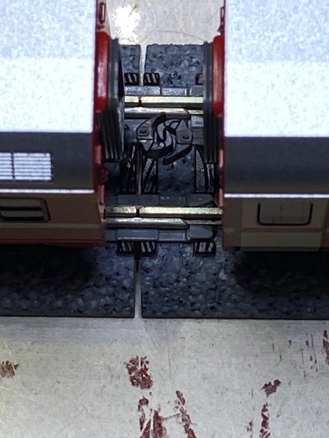

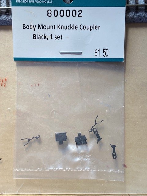

After looking at the ngauge thread, I remembered that I have the body mount close coupling that was being used for the front of the steamers. I had done this mod a while ago when I saw the Shigemon video. The shank of it is very thin, so I gave it a try.
It fits and the two spring parts land in the bogy coupler mount to actually work, but they are a bit stiff. The couplers are a bit long. I have included pictures of the spacing differences.
The Kato US part is 800002 while the Kato JP is z05-0746.
I have another set of couplers coming in and hope they fit better. They're for the C11. I actually found that part by going through all of my steamer parts listings: D51, C62, C11, C12, C56. Still taking a gamble on the C11 part. If it doesn't fit, I will probably go with the 800002.
