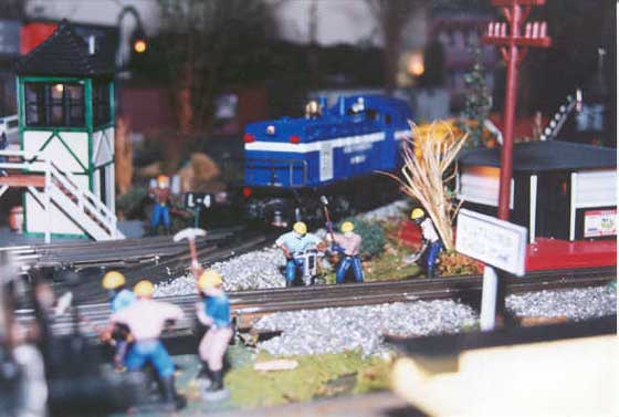

to2leo Posted January 5, 2010 Share Posted January 5, 2010 So I was wondering, does kitty litter make a better ballast, and is it more cost effective? I really don't want to buy tons of the Woodland Scenics ballast, and a more "Japanese" style? Hi Nozomi, I was half kidding when I suggested it. This idea has been running around in many scales especially in HO and greater. I think this all started by an issue of Model Railroader magazine back in the 90s with someone who also has cats as pets. A quick search of the Web comes up with these interesting links. http://www.trainweb.org/danderso/tips/track-tips.html this one shows how kitty litter is used on the layout http://www.ilovelbny.com/files/trains5.jpg Link to comment
