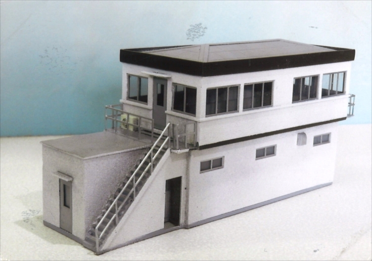

gavino200 Posted April 4, 2021 Share Posted April 4, 2021 Not really sure what these buildings are called. I think its sort of a control/lookout tower for a station. I bought this a few years ago but, didn't complete it due to a move. All that's done is interior light proofing for illumination. Black primer, then white primer. I like the structure, but like many Tomix structures it looks very plasticky. I think it needs to be painted. It also needs an interior floor to divide the two levels. That's the first job. Next I need to find some prototype photos to guide my paint choice. 1 Link to comment

gavino200 Posted April 9, 2021 Author Share Posted April 9, 2021 The tower is painted and I gave it a thin clear coat. The windows are cut to fit a floor piece that's ready to size and fit. The last thing will be to fit an LED. I just realized that an LED would be fairly pointless. I don't know if these towers were ever used at night, but if they were, and you turned a light on inside, you wouldn't be able to see anything at all through the windows. I'm going to put an LED in it anyway. 1) I just like lit structures. 2) This structure will be a bit difficult to light as there's very little wall space to hide a wire. I'll have to use magnet wire, which I hate. I think I'll learn from the challenge. 1 Link to comment

gavino200 Posted April 10, 2021 Author Share Posted April 10, 2021 I stuck with essentially the original color scheme. I mixed a beige that's similar to the plastic beige color. The brown lines are painted rather than the stickers that come with the kit. I also painted the doors and railings. The interior light doesn't make much sense so I used a very small LED and a large resistor, to make it look like a faint glow, perhaps from surveillance screens. In person it's much less bright than it appears in the picture. I considered making a desk with a computer or some monitors but decided against it. I have too many awaiting projects right now. 9 Link to comment
Kiha66 Posted April 11, 2021 Share Posted April 11, 2021 Nice work Gavin, that paint job really improves the look of the tower. 1 Link to comment
serotta1972 Posted April 11, 2021 Share Posted April 11, 2021 18 hours ago, gavino200 said: I stuck with essentially the original color scheme. I mixed a beige that's similar to the plastic beige color. The brown lines are painted rather than the stickers that come with the kit. I also painted the doors and railings. The interior light doesn't make much sense so I used a very small LED and a large resistor, to make it look like a faint glow, perhaps from surveillance screens. In person it's much less bright than it appears in the picture. I considered making a desk with a computer or some monitors but decided against it. I have too many awaiting projects right now. gavino200 continues to earn modeling creds - getting close to next level, keep it up. Unlike me, I'm stuck at level 0.5. Haha. 1 1 Link to comment

inobu Posted April 13, 2021 Share Posted April 13, 2021 On 4/10/2021 at 4:23 PM, gavino200 said: I stuck with essentially the original color scheme. I mixed a beige that's similar to the plastic beige color. The brown lines are painted rather than the stickers that come with the kit. I also painted the doors and railings. The interior light doesn't make much sense so I used a very small LED and a large resistor, to make it look like a faint glow, perhaps from surveillance screens. In person it's much less bright than it appears in the picture. I considered making a desk with a computer or some monitors but decided against it. I have too many awaiting projects right now. That came out good. The rails should keep OSHA off your back as well. Inobu 1 Link to comment
