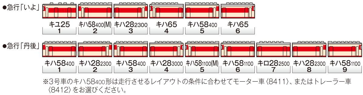

Kiha66 Posted October 5, 2018 Share Posted October 5, 2018 (edited) 21 hours ago, GDorsett said: When you say "ten car set", is that what the model will pull or is that how they ran? The kato powered car is more than sufficent for a train of any length, but in general the ran in lengths of 2 to 12 cars long, depending on demand and the route. Tomix has some example consists, but all the cars work together so unless you are modeling a spicific line at a spicific time, you can just mix and match as you please. Normally a small train would be a mix of 58 and 28s, while a longer train might have one or two kiha 65s and kiro (first class, with no cab) 28 cars in the train. https://www.tomytec.co.jp/tomix/products/img/8412_h.gif Edited October 6, 2018 by cteno4 Removed Image embed 2 Link to comment
