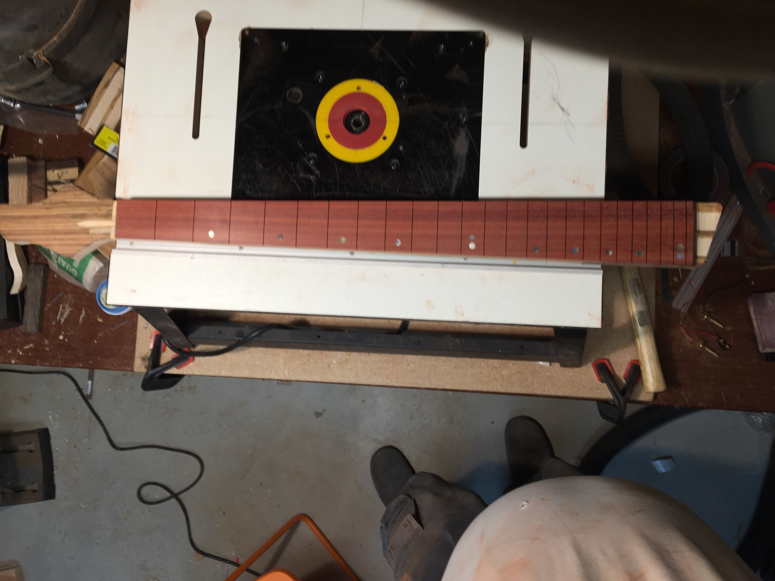

Next came making the necks.  They are laminate of multiple strips of maple and the same kinds of wood used in the bodies.  For the headstock front I bought thing Wenge for his and thin Zebrawood for mine.   The necks have some carbon fiber tubes in and of course truss rods.  I bough the fingerboards pre-cut for frets.  I forget what sort of wood he chose for his fingerboard (brownish one) but I chose red bloodwood for mine.
IMG_4926.JPG.50ab5ea201c429ad5ff73cd20f02d4c7.JPGIMG_5366.JPG.3abb602ea7d176072594df48ac82b538.JPG
IMG_6035.JPG.ee3b1a3d96bf65409e87b757d95107ff.JPGIMG_4946.JPG.27a26fa2977cec86168af2b9d153b1fb.JPGIMG_4985.JPG.b49e44e21280e629961825fb379b544a.JPGIMG_5010.JPG.f5b8fef684b3f798c0f93da704788882.JPGIMG_5368.JPG.d1f4c64f8bf26264acb1905b4e00303d.JPGIMG_6033.JPG.08c7fc741bd50905bd6b73a88ea7e284.JPGIMG_6191.JPG.b4cad90bc050bf15f4cfaadf47fed14c.JPGIMG_6193.JPG.440c033df4e381c5fbbebcc640dbef60.JPGIMG_6233.JPG.613cde54cf2e8a833c0834fdde9ea4f2.JPG
Next you cut out the neck pocket and put holes in so you can bolt the neck on etc.   Various end-stage pics of both the basses.   Both still need the oil finish and mine I had to take the nut off and put a new one on.  The new one is on but not yet cut.    He has been playing his for a few years.
IMG_6127.JPG.eed340e6ff50c3bbef93eda968f9436b.JPGIMG_6121.JPG.2a7c67afbd28fb61564298091120728b.JPGIMG_6168.JPG.96403680b38cf78e706c7d373be20eb9.JPGIMG_6284.JPG.50b4f79c41c4ac27d7eb7b10492ca1d5.JPGIMG_6270.JPG.d04c4b728e3118eb5e801193ce6256b8.JPGIMG_6249.JPG.9ec71808f23b6339e8aa259407ac03b1.JPGIMG_6529.JPG.601f422cc15bd4d0a0190ec9669b45d6.JPG
Lastly here is some more stuff I have done.  I have built a lot of neck blanks for various projects, including the two 6-string basses.  I also bought the stuff to cut my own frets so all these necks will have fingerboards I cut myself.
Then there is some of the work being done on the two 6-string basses.   These have a back of walnut, old growth fir for the main block inside, and another layer of walnut and then nice myrtle for the top.
IMG_6240.JPG.46c68cb01ea45f903ec3b54ba072c6f7.JPGIMG_6267.JPG.70beac561eb43b320f2e2773a5e635aa.JPGIMG_6741.JPG.d78abf8a789ad2aacb8cd963b5658d0e.JPGIMG_6795.JPG.ae315917316e3c784571d882e5aecdaf.JPGIMG_6828.JPG.d8e2f0a5e615d0e6cd56ac3ed8549ce9.JPGIMG_6850.JPG.47fe5e2df418e6f71244483610773128.JPGIMG_6855.JPG.587779e6b44f61102be737c18a12118c.JPGIMG_6863.JPG.c3cfb86c0709437ce5a2d56a0a0b74ae.JPGIMG_6864.JPG.57d7af5b6e2ee2e7c46c12eaae84bc81.JPG
Here are the necks being worked on for these two basses.    The last picture is basically the stage I am at now.
1F60B4E3-294B-42C3-91A5-0E00539B76B3.JPG.da67ec2ea5e34c7c78e4e85b8b65e024.JPG5074522A-EB48-4E95-88D7-5288E7C42320.JPG.93cc949f171829c8e749ad498d97b8cd.JPGA84F06CB-4413-4300-A541-3A867469F4B4.JPG.e69e9a5cece92f8c5a76053197b613c1.JPG7D206818-FCD2-4B4D-9792-1F1C92FF1D76.JPG.1eb9f896359b466378d545c572d3f43b.JPG518E4412-FD47-47E6-B928-2542806B1A90.JPG.5773601171b99455b25a0d69f05547c2.JPGCC09E031-801F-4EAC-9060-8C68C80AE6D8.JPG.36e8cfbd7315ac4bb5a38b2fdb1be9c7.JPGC0A8BAF6-75EB-41E3-9600-7F5ED17A4E0D.JPG.2e90d17d1ba80a1df6e21aa902cb7ca5.JPGIMG_1409.JPG.bf168641cce2bdf9c21f9f16c730cc60.JPGIMG_1412.JPG.2f3365199ee7fd3a38d4a0e3325309b6.JPG
