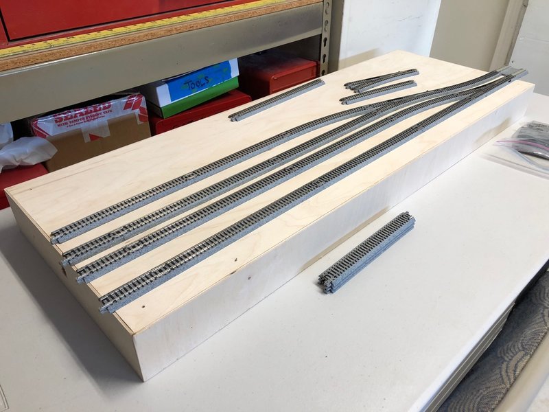

I'm working on building a yard / staging area and would prefer to use #6 turnouts rather than #4's and this is what I ran into.  I might have to settle with the #4's and read up on the necessary work to make it perform better.  I will use 2 triple deep modules to start and can always add center pieces to make it longer as the goal would be to accommodate a 16 car Shinkansen.
With the #6's, the ends didn't quite line up and are also not long enough.  Only the first track had the little overhang.  Will continue to fiddle with this and try to make it work.
With the #4's they fit perfectly and have slight overhang that is needed.

Yeah when you start doing various odder ladders the spacing will go off on you. It can take some fiddling to get it just right for an order arangement as sometimes impossible for perfect Ttrak joints. One solution is to make a custom straight by cutting out some of the roadbed in the middle of a straight, sliding the two ends together and cutting rail to length. Then glue the two pieces of roadbed together with some epoxy.
also if it’s not the main lines and these are run as dedicated modules together, the yard tracks could just mismatch by a few mm on the ends (ie one sticking out on one module and the other inset a little on the other module).
Awesome work Junior!  For the two middle tracks are you using s62 or s64s for the short straights at the end?  If its s62s switching to s64s will give you a little more distance.  I found a example diagram, seems the #6 switch and 718-15 curves need to use a few s64 length straights to bring them back to the 62mm unitrack standard.
5a8bb29f27be2_kato-unitrack-20-202-6-left-turnout-with-28-1-4-radius-curve-2-21-p.thumb.gif.ecaeb51aa0d20b896375b8a3443703d5.gif
Cool, thanks Sam.  I will get some S64's, I think that will do the trick.  Yay, I will get to use the #6 turnouts and will 6 tracks in the yard.
