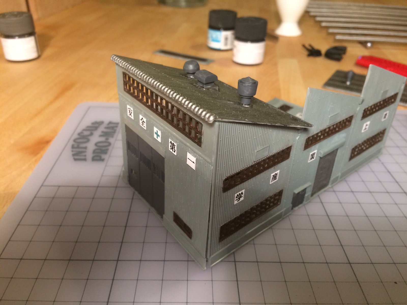

Khaul Posted December 11, 2017 Share Posted December 11, 2017 I have been painting the Greenmax factory kit. 10 Link to comment
valkyriepm Posted December 11, 2017 Share Posted December 11, 2017 2 minutes ago, Khaul said: I have been painting the Greenmax factory kit. Really nice! I started to build it myself. Looking forward to see it finished! What will you add to the scene? 1 Link to comment

JR 500系 Posted December 12, 2017 Share Posted December 12, 2017 Nice work on the Greenmax factory kit! Very detailed indeed! Link to comment

Khaul Posted December 13, 2017 Share Posted December 13, 2017 (edited) I put the factory together today. I made a mistake so I had to unglue, switch over and re-glue the roofs. The kit itself is a bit nasty. I had to cut bits of plastic to make it fit, but I managed to make it work. I'll still need to add a tiny bit of putty in the cracks and touch up the paint. Happy overall. I have applied some dry brush rust, one of my favourites. I think the red of the DE10 goes very well with the factory colour. Edited December 13, 2017 by Khaul 11 Link to comment

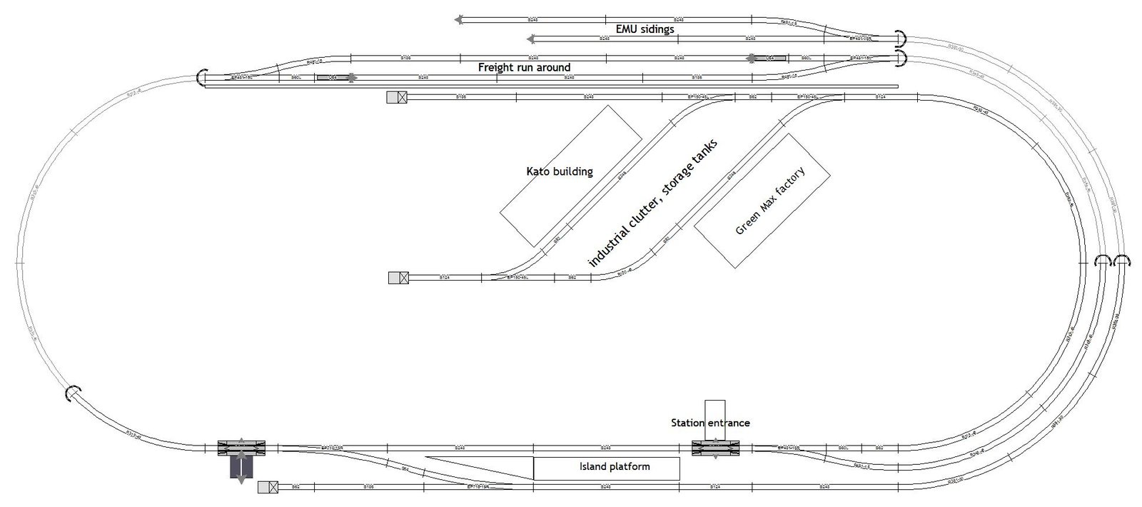

Khaul Posted December 14, 2017 Share Posted December 14, 2017 On 12/12/2017 at 10:36 AM, valkyriepm said: Really nice! I started to build it myself. Looking forward to see it finished! What will you add to the scene? I've thinking how to better integrate the industrial buildings in my layout. I think I have found a fun yet simple way. Industrial buildings are rotated 45 degrees so they can be seen from multiple angles. It could all fit in a 340mm x 910mm. It could be possible to add a third parallel 45 degree track and then split the industrial area in two 340 x 600mm modules. This solution deals with the problem of filling the centre of the layout. Industrial tracks will be mostly embedded, or course. The plan relies on my DD13 and/or DE10 to be able to negotiate the mini turnouts. Operations require switching, but this is not a switching puzzle. Loads are stored in the "flat" track at the top. Empties come from the main line into the branch. They are left in one of the 45 degree tracks. Loco turns around and spots the cars to the correct tracks. Then takes loads out. Easy. 3 Link to comment
valkyriepm Posted December 14, 2017 Share Posted December 14, 2017 Nice design Khaul, it still have a lot of space for develope scenery. DE10 and DE13 will do fine on the mini switch. Mine will be a micro layout with a refinery, still thinking on the layuot design tho. Keep us posted, looks great! Link to comment
cteno4 Posted December 14, 2017 Share Posted December 14, 2017 Khaul, nice, gunna have to rip that off at some point, it’s a nice little simple but fun switching set up and I love the 45 off set ans the buildings on the outside and cutter dividing the tracks! Sweet. kudos on your weathering perfect rust application on that structure, really makes it pop! Did you just hand paint the windows or mask them and airbrush them? The @#$& moulded in window on greenmax are always a pain to paint out easily. Not found the Magic way to make it easy, tried masking ans spraying, hand painting and markers ans all have their issues... jeff Link to comment
Khaul Posted December 14, 2017 Share Posted December 14, 2017 Jeff, I have never been even close to a paint brush. I have tried masking and painting with a normal brush a couple of times and failed miserably. The paint always bleeds below the masking. I will start a please give me masking tips thread soon if I don't find one. So I did everything by hand for the factory. I learnt the hard way that Tamiya paint from the hobby shop works very well on plastic. Just a couple of light coats and it looks quite nice. The problem is I don't have many colours. For instance, the walls are a Royal Navy battleship green I had lying around. I first tried to paint the windows white with a German brand acrylic paint. It was too sticky and the result looked patchy so I cleaned with alcohol and tried a non-Tamiya black, bit better but... I finally settle for the brown artist acrylic I use to paint rails. It is still too thick and tend to clot, but it covers well. As you said the windows were a pain to paint, but sort of a fun pain. 1 Link to comment
