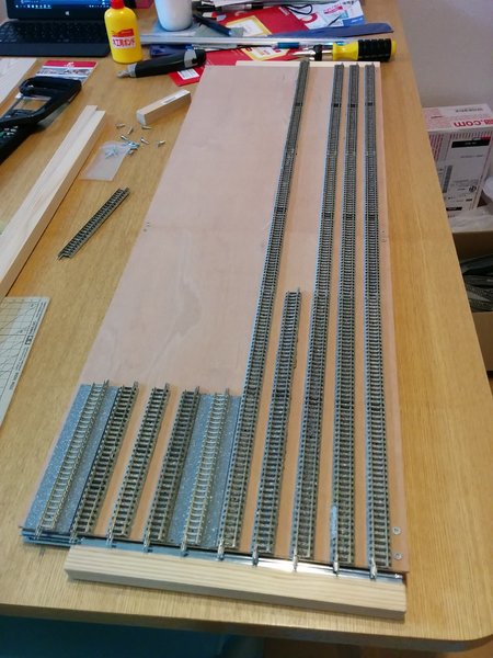

ToniBabelony Posted October 6, 2017 Share Posted October 6, 2017 My ideas always change, but the need for a staging yard is always present. I was playing around with the thought of having a modular staging yard for my trains to use on the dining table (or somewhere else). So, I stated making a traverser that could hold at least six trains. I ended up making one for ten or nine trains (depending on how it all works out). I'll keep electronics very simple with current flowing through the physical connectors that secure the tracks in the correct positions (probably like sliding locks). Train lengths will be 6x 20m cars and equivalents of that in different lengths. And yes, I need a loooot more track... 6 Link to comment

ToniBabelony Posted October 11, 2017 Share Posted October 11, 2017 Traverser project is slowly moving along: I actually don't need to stabilise it anymore. At first I thought I would tip when fully slid out, but it doesn't, so I'm quite pleased with that result. Tbh, I just need tracks, adjustable feet, and it's ready to be finished and used... Detailing can come later. The most important part (stability and durability) has been successfully finished. 6 1 Link to comment
cteno4 Posted October 11, 2017 Share Posted October 11, 2017 Very cool toni! Are you going to drill some holes for an indexing lock/peg? i might have to think about this for a truncated jrm ground track yard when we don't have room for the big yard. jeff Link to comment
lighthouse Posted October 11, 2017 Share Posted October 11, 2017 Nice work! how do you want to lock the track yard? Link to comment
ToniBabelony Posted October 11, 2017 Share Posted October 11, 2017 I bought some simple metal sliding locks to keep the yard in place, as well have current flow. No complex wiring required, no switches required, as the lock will do all the work. Hopefully I can show you more progress after I've gotten the tracks to let the project make more sense... I also probably need to level out the tracks with an underlay on either side, so that will also act as a dampener for sound. 1 1 Link to comment
