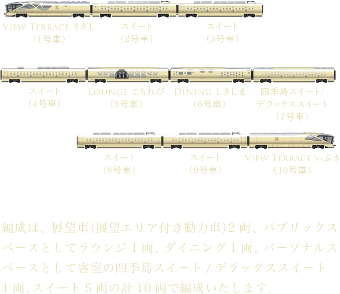

VJM Posted December 5, 2015 Share Posted December 5, 2015 Given the pictures, it's not loco-hauled. http://www.jreast.co.jp/shiki-shima/train.html Link to comment
SuRoNeFu 25-501 Posted December 5, 2015 Share Posted December 5, 2015 Given the pictures, it's not loco-hauled. http://www.jreast.co.jp/shiki-shima/train.html It has been already revealed long ago (but not longer than a century ) that the train is a EMU. Well, we already know that distributed power system allows a train to be more punctual in the timetable, so this is the reason why JR East decided to use EMU base for this luxury train Link to comment

kvp Posted December 5, 2015 Share Posted December 5, 2015 http://www.jreast.co.jp/shiki-shima/img/train/page6organizationsp.png Looks like two driving generator cars, 4 or 8 electric motor cars and some trailers in the middle. So i guess either Tc-M-M-T-T-T-T-M-M-Tc or Mc-M-M-M'-T-T-M'-M-M-Mc (with M'-s being either pantographless motors or trailers). 3 Link to comment
