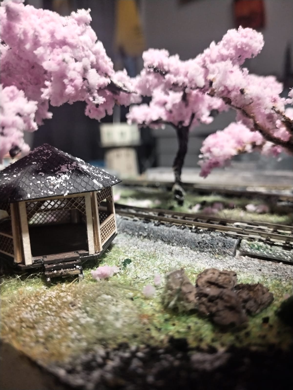

Kirsikkapuu Kääntöpöytä (Shelf Layout, Modular Extension) Status: (Needs Tweaking, Possible Rehash) Type: Challenge, Hybrid Modular x Self Track: KATO Unitrack, Minitrix N, Fleischmann Piccolo. Base: XP Foam. Operation: DC Features: Cherry Blossom Trees, Turntable, Challenge. SCARM: Description: Like many, I love watching YT content to get inspired for modelling and model railways. One of the ones I like to watch is Budget Model Railways—kinda like their vibe. Anyway, they had a shelf layout 60x23.5 cm and posted a challenge for it. With my inclusion in the city's makerspace, which gave me access to multiple used wood and foam materials, I went on a date with the sanding machine to create a makeshift shelf with the proper dimensions. Here are my limitations. Rules: To produce a layout of any scale/gauge on a 60cm x 23.5 cm floating shelf. Thickness of the shelf does not matter but must not exceed the 60cm x 23.5cm dimensions. It must have at least one point/ switch and have as much operating potential as possible, ie not a single track diorama. Any type of track inc pre ballasted is acceptable. Ovals are acceptable if they can be fitted in, as long as there is at least one point/switch. It must have two buildings/structures as a minimum, but this can include sheds, signal boxes etc. Backscene can be any height. The fiddle yard must not exceed 60cm in length or be more than two road, it must be separate from the scenic section, i.e. no 4ft boards with only the 60 x 23 section as a layout. The layout should include as much second hand and recycled material and features as possible. The objective of the challenge is to inspire people to have a go at making a micro shunting layout, especially those who have not built a layout or micro layout before, and to do so on a limited budget. Whilst I will be interested to see any layouts outside of the criteria, only those that meet the criteria will be featured on the website. There is no prize or reward, or ranking 1st 2nd 3rd etc, its just a fun challenge to inspire people to enjoy making a micro layout The first challenge is figuring out what to do. The rules are that it must have a turnout for operation and not just a straight line, as well as at least two structures. It can feature a separate fiddle yard. It is also possible for it to be an oval. It was emphasized that the materials used for the diorama should be as recyclable/used as possible, fitting the budget aspect of it. I had a Fleischmann Piccolo manual turntable and decided to measure it in. To my surprise, it fits snugly in the 23.5 cm width. I then connected the tracks and exchanged the extensions of the turntable. I found that both Tomix and Kato tracks are perfect for the turntable as they have a similar height to the structure, so I fitted them in. Yet the Minitrix track with the turnout was, of course, too short, so I had to support it with card and cover the blemishes with ballast and grass later on. The tracks on the right could be a fiddle yard using Tomix track, or connect with the 4-season modular layout on the left. The structure was coming along well, and choosing buildings was easy. The turntable itself is a large feature, and I had an unused building that worked perfectly as a “worker's apartment complex.” Did the usual grassing, but this time I also made my own static grass using brown thread soaked in paint, and painstakingly cut bit by bit. It worked pretty well and Im pretty sure itll be excellent when used with a static grass applicator. Yet despite so, it still looked bare even with the shrubbery. I remark how opportune coincidences happen at the most opportune moments, but in the Discord, @Martijn Meerts and I were coincidentally suggested cherry blossom layouts and designs by the YT algorithm. These are the following videos. I remarked that I would kill for a 24-366 KATO x Woodland Scenics cherry blossom set. But, defeated from seeing how morbidly expensive trees are, I decided to make my own, and I thought of using a full cherry blossom garden as inspiration—particularly Roihuvuoren Kirsikkapuisto in Helsinki, an entire park of cherry blossom trees created as an act between the Finnish and Japanese governments. So I began constructing my trees. I featured them a little in Discord and one of the forum threads. My process initially was 3D printing tree armatures that best fit cherry blossoms. When I saw the free ones barely looked like cherry blossoms, I decided to buy some florist wire and create the trees myself. It was a long and tedious process that I mostly had to use tools for, but once I began to understand the rough idea of making trees using wire, I found the process rather relaxing. I built different types of armatures, thin and large. The first large armature was painted dark brown, as cherry blossoms are commonly found to have dark bark. It was my first tree and test tree. One of the issues I had when I placed the pink foam on the tree was trying to trim the trees from being too puffy. Most of the techniques I saw were a mere splash and shake of the pink bits, but since my foam was more joined together, I had to place it properly. My partner helped me with trimming the foam while the glue was wet. It is also at this point that I am considering getting an aerosol-based glue spray for the trees to make sure it sticks, but it is still rather expensive. The tree armatures were initially made using a mix of paint and wall hole putty, before trying with glue and paint only. The former was very difficult to use, as wall putty was rather hard and dry in the hands. Glue and paint only was too wet and still left some exposed wires after drying. I decided to try a mix of all three and used a lighter colour for the bark to mimic other varieties of cherry blossom. Also, Lukes Models—now known as Boulder Creek Railroad—used to make a good video on wire trees with added static grass for tinier branches, and I did just that. The resulting tree was very good. The triple mixture made a very hard and barky feel to the tree, as well as being really easy to work with compared to silicone. It’s also good enough to reshape your trees after the mixture has dried. A little bit of white powder on the trees and on the ground to mimic the fallen cherry blossom petals makes it excellent. I also had some tiny parts of the homemade pink foam that I pasted on the ground. While it provides a little contrast, it’s rather peculiar to have piles of cherry blossom leaves like that, decided to stick with it for the color it gives. But maybe for the next one I can just paint white powder with the pink Vallejo paint (maybe baking powder?). For the final touch, I used a mix of glue, light brown, and static grass to create the walk path. The asphalt uses black ballast instead of the Vallejo Diorama FX (since I can’t find it—must be in storage). The station module was still rather bare, but I 3D-printed a little shed. I might print something else or repurpose it as a depot. Also used the gazebo from the three bridges layout so it provides more flavour to the scene. However, the layout did have a major failure point—the turntable. It wasn’t working initially, and people suggested to me that it was due to oxidation. The turntable had a date with the track rubber, and trains can work now. However, there were still some issues. The turntable doesn’t fit properly into the extensions where the train should get off it, so locos with lower chassis either get stuck in the middle or derail. Instead of manually turning it and having a simple turntable, I literally have to carefully align the tracks so a limited number of trains can pass through. It honestly became a complete chore. I can perhaps try to file the tracks or really align them with the turntable. But at some point, I’m kinda done with it, to be honest. I’ll be bringing this module to the exhibition tomorrow and submitting the pictures to the YT channel for the challenge. But I am planning to rip apart the turntable and trackwork, and install a double track with a Kato double cross 310 mm. Also didnt like the minitrix track, it really does look out of place. Overall this is what it looks like, by far this is my prettiest layout with the best pictures. Absolutely love the flavor it adds. I just wish the turntable was more operational. I love making my own trees and will start doing so, and the static grass I made were incredibly economical compared to buying ones from Noch or Woodlands. Maybe getting an applicator is good. I am tempted to make side modules with backscene to make excellent pictures. Running Video: Attachments: -
