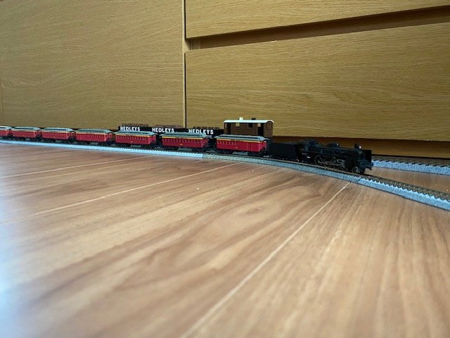

kusojiji Posted March 31 Share Posted March 31 Just some stuff I've been working on. So, I noticed that the KATO N D51s don't have a tail lamp. I took one apart and found that the dummy light is actually fitted with a clear piece that can act as a fiber optic, so... 3mm LED, 2K resistor, aluminum tape a voila! Ah, cannot add a movie file, bummers. Uploaded snapshot from movie file. All the latest D51s can do this. I took a look at the C62 but no go on that one. I did this to my UP Big Boy and FEF, but have to figure out a better way to get the power. My original design put too much pressure on that last bogey. 4 Link to comment

kusojiji Posted April 11 Author Share Posted April 11 20 year old Kato D51. Motor fried, but it ran very well when healthy. Installed a 615 coreless motor from Tramfabriek along with a gear and adapter, and 3D printed a motor mount for it. This was at least a year long project that I finally got off my duff to get done. Took 3 prints to finally figure out what I needed. It runs very well now and is almost as quiet and low voltage as the newer Kato steamers are. Next up is a C57 that has a fried motor. Same type motor as the D51 and no longer available. Brush springs are the issue and they are smaller than the newer motors from Kato. 2 Link to comment
kusojiji Posted Monday at 09:34 PM Author Share Posted Monday at 09:34 PM I wonder if I should pull out all the gears and make the conrod do the work. Might be less friction. The newer Kato stuff only has one axle drive now. Also, the traction tires (almost spelled it tyres - spending too much time on the UK forums haha) have long since gone to see buddha. She runs fine without them but can probably gain some connectivity if the wheel were not grooved. Finding spare parts are next to impossible. There used to be junk shops around, but no clue where nowadays. Link to comment
